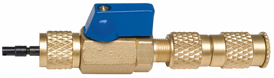

Hello; Has anyone used the tool that allows you to remove and replace the AC Schrader valves without evacuating the system?
Yes, I have. But, when you have a leaking schrader valve, chances are that the system pressure is pretty low so it can be done, just do it when its cold outside and you have not operated the car. That’s when the system pressure will be at its lowest. There will be leakage but it can be done.

I purchased one of these to swap out the Schrader valves without dis-charging my A/C system. Unfortunately, it doesn’t work for my Ford truck because Ford uses a high-flow valve, not a standard Schrader valve. Worked great for my Toyota, tho.
Thanks; do you think it will work on a Saturn?

Exactly how does the tool work? How does it remove and replace the valve without the system leaking
you tube valve core removal tool. it is simple and ingenious. Like separating chambers and isolating your issue. check it out.

also; will the tool work on the UPPER A/C valve (high pressure)
Normal clockwise thread. If the system is not running, the pressure in the high and low sides will be the same. The cooler the system is, that is weather wise and under hood temperature, the lower the pressure. Its best done early in the morning before the car has been used. Also less wait time at the ER, just in case.
