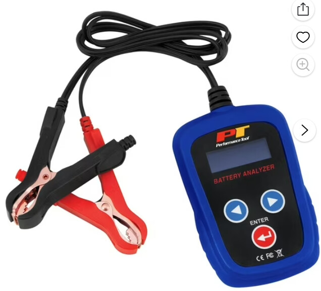

I measured the voltage at the battery terminal and got 11.79 volts, with the car at rest, and not attempting to start it. The battery is from January 2019. It is an AutoCraft Gold, Part Number 24F-6. It has a rated capacity of 750 CCA. I used a performance tool battery tester.
It’s not to intuitive on how to use it. But upon connecting it to the battery I get “BATTERY TEST” and select the enter button. It prompts me “BATTERY TYPE” with options of “STD” or “AGM”, I seleted STD as I believe that is correct for this type of battery. I get prompted with “RATING STANDARD” and shown “SAE”, pressing the left and right arrow buttons doesn’t seem to do anything, so I think it’s the only option. After pressing enter on SAE, Im shown “BATTERY CAPACITY ### SAE”. I used the right arrow until “750 SAE” is displayed and press enter. After the test is completed I get “BAD REPLACE”. So I think I need a new battery for this car?

Have a battery conductance test performed on the battery.
This type of test doesn’t require the battery be recharged to determine the condition of the battery.
