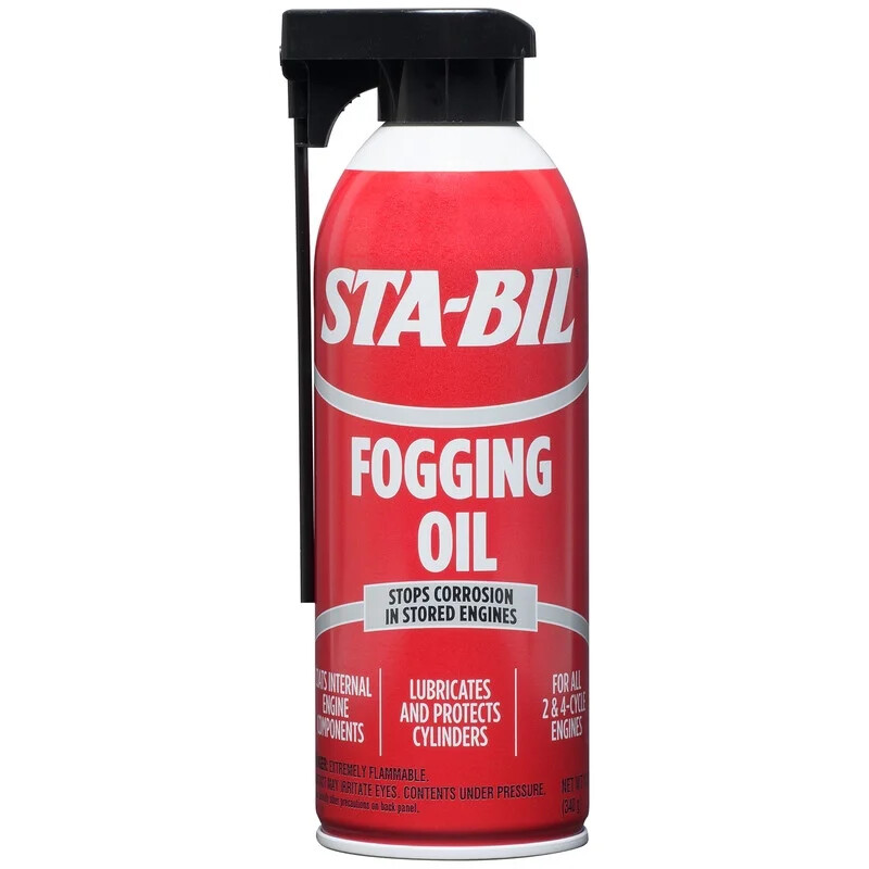

Go to the parts store and buy a can of fogging oil.
Give a quick spray into each cylinder before reinstalling the spark plugs. No muss no fuss.

It’s NOP to fog the cylinders in vehicles that are stored over the season where I’m at. We call it common sense.
.Unlike regular motor oil, fogging oil clings to the surfaces inside cylinders and doesn’t drain off the surfaces over time.
Yes, fogging oil is specifically designed to protect engine components during long-term storage by preventing rust and corrosion, while engine oil is used for lubrication and cooling during engine operation. Fogging oil typically has a formulation that allows it to adhere better to surfaces, providing a protective film.

B.S.
An engine burning oil can clog a catalytic converter,
It’s not like your filling the cylinders up with fogging oil. Just a quick spray is all.
We been fogging our engines for many years. and not once have we run into a problem with fogging the engines before storage.
I fog my 2 stroke outboard engines even though they only sit for winter. I don’t fog modern car engines for the reasons cited. Proper fogging to get the ring surfaces coated requires running the engine until it emits smoke out the exhaust. None of my engines consume enough oil to damage the CC. Too expensive component to risk when I can just as easily take the plugs out when I’m ready to run it and turn it over by hand. Even if I fogged a legacy motor, I’d probably still do that as a precaution.
