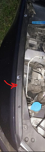

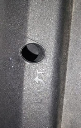

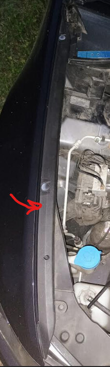

Anyone know how to remove this trim? There’s an arrow with “L” and “R”, which I assume I need to but some sort of allen key or socket into to release the trim? I’m not entirely sure.

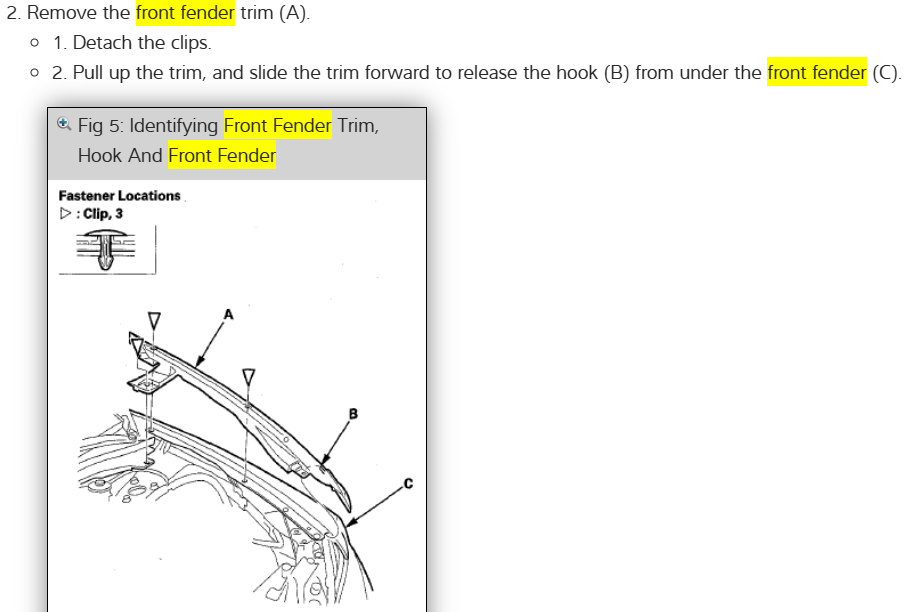

The retaining pins holding the trim should be similar to door panel retainers. The “L” “R” access hole is for headlight adjustment.
Thanks. I think you are right. I believe that plastic piece is called
And the three pins are
That L-R opening is probably for access by a screwdriver to adjust headlights. It should not be plugged or blocked.
