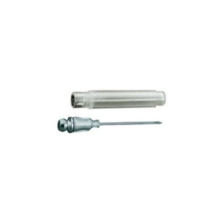

You might take the vehicle to a shop and ask them to grease the ball joints with a needle greaser.

Wally World sells a needle greaser.
All you need is a grease gun and a cartridge of grease.
Then remove the front tires to gain access to the upper and lower ball joints.
