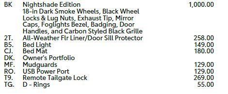

That’s something I should check on my 23 Tacoma, with the proximity locks I’ve never even tried the physical key.
Don’t forget the tailgate lock… lol
BTW, doesn’t yours have the power lock on the tailgate??
Mine didn’t come with one, but it is on my list of things to install one day…
Anyway, I have used my key a few times when I wanted to lock the doors with the truck running and the doggies in it, I hate though that the fob/smart key (and handles) stops working when you lock the doors using the key… lol
Forgot about that lock, The power lock on the tailgate was an option, but yes It does have it.
