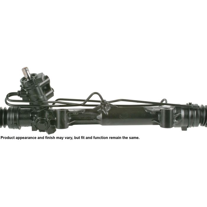

http://contentinfo.autozone.com/znetcs/product-info/en/US/atp/64245/image/8/
Here is a picture from autozone for it. They call it a Rack and pinion my book / repair manual calls it a steering gear. That is where it it leaking from. Don’t think that there should be any fluid in the boot from doing further research so might be the internal shaft sea.
The end seal of the rack & pinion assembly is leaking into the rubber bellows you see on the end of the rack & pinion assembly. But before replacing the R&P assembly, you might want to give this a try. http://www.lucasoil.com/products/display_products.sd?iid=28&catid=9&loc=show&headTitle= - Lucas Power Steering Stop Leak
