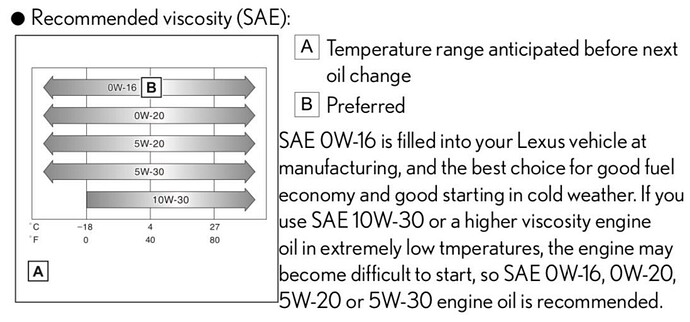

Just wondering if Mobil1 High Milage is ideal for a two-year-old engine, or use 0W-16 specified.
Toyota has several vehicles with the exact same engine. The ones built 5+ years ago have a oil viscosity recommendation of 0w-20. Exact same engine built 2 years later and the oil recommendation changed to 0w-16. And now it’s 0w-8. In all probability any of those oil viscosities will be fine.

It is meant for engines with weeping seals, do you leak any oil? If not, 0w-16 is ideal for your car, and will provide slightly better mpgs.
Thicker oil (to a point) is better for piston ring seal, and with your 193K miles it might help it some, all the bearings and such will also have some wear and more clearance (we are talking in the 0.001" range, NOT 0.1") and so the thicker oil can help there also, BUT, it could affect the VVT system… So run the thicker oil and IF it throws a CEL or fuel mileage decreases then you can just change back to the OEM oil… Don’t over think this…
The A25A-FXS engine in your Lexus has used 0W-16 engine oil in the US market since it was introduced in 2019.
That engine was later certified using 0W-8 engine oil for the Toyota Crown.
If you lived outside the United States, you would have more oil viscosity choices.
My wife owns a Crown now. The 2 dealer oil changes done as part of the sale use 0w-8. I use 0w-16 and will do the rest of its life (or mine whichever comes first).
May make sense to use 0W-8 for break-in. Then 0W-16 for regular use until engine attains high mileage.

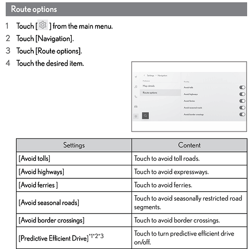

Can a satellite detect a traffic accident? You can display traffic conditions and choose your route accordingly. Traffic condition information is received via the Data Communication Module, not GPS. You need to be in range of cell phone service.
Review your route preferences. Be sure to switch off Predictive Efficient Drive.
Thank you.
Yes, the GPS is set to show traffic problems.
