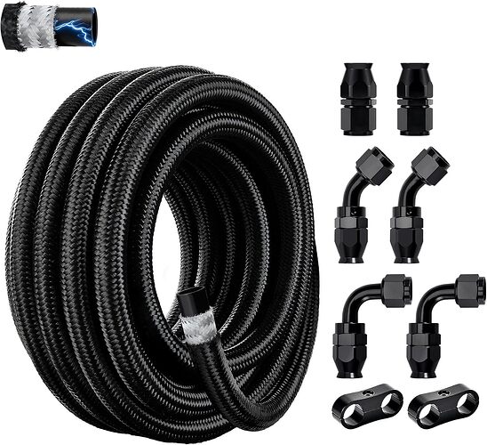

I did see a kit from a company called Evil Energy that looked good. It seemed kind of pricy at first but looks like high quality stuff. Requires AN fittings but it looks like they have everything. But after seeing the prices for some of the stuff we have been able to buy locally, it is starting to look like a bargain.

I think I have found my answer and it doesn’t look like the OEM fitting. Looks like the two best answers are from Evil Energy.
This one appears to be the best. No special tools needed, just the right size wrench
This one is a push on but how it is disconnected is not clear, but it is for frequent repeated use. I don’t know if it takes a special tool or you just squeeze the blue piece.
I don’t like that they require AN fittings to be used on the fuel line, but then the fuel line they are designed for is PTFE lined, steel and nylon braided synthetic rubber.
While this stuff looks expensive, it is actually cheaper than the stuff at the local Auto Parts store. Just plain fuel line (EFI rated) runs about $13/ft without any fittings.
Last update, bought the hose from Evil Energy, but not the steel braided one. Cut the old hose off the fuel rail QD and clamped on the new hose. Bought a plastic QD from O’Reilly’s that matched the OEM and put it on. Used the sealant for fuel hoses at the connections and fuel hose clamps, not the worm drive clamps.
