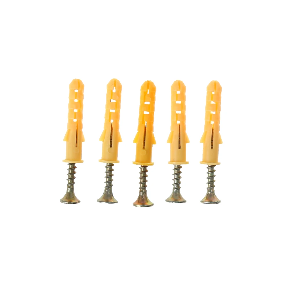

Check Lowes or Home-Depot (or what ever home improvement store in your area is). I had a similar problem and in the fastener section with the pull-out drawers, they had a pull out drawer with different types of fixes for this.
My Tundra didn’t even have holes for front plate so I drilled the holes and used drywall anchors. Work like a charm.
