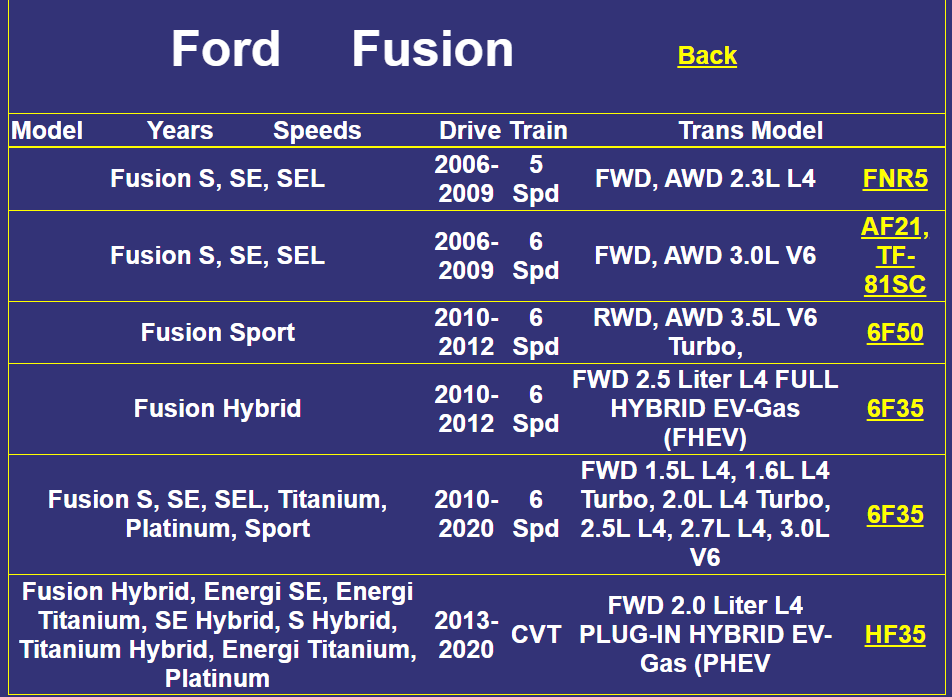

Transmission Types by Engine:
  • 1.5L and 2.0L EcoBoost: 6F35 six-speed automatic
  • 2.5L: 6F35 or 6F50 six-speed automatic
  • 2.7L EcoBoost V6: 6F55 six-speed automatic
  • Hybrid and Energi: eCVT (electronic continuously variable transmission)
Look for an ATRA member shop in my opinion. I’ve never paid more than $3000 but some are more complicated.
Need more info from the OP, what engine is in the vehicle, and is it a CVT or a 6 speed automatic transmission??

So it’s a hybrid, according to the table?
See 2nd from bottom…
Yep! I stopped too early…
