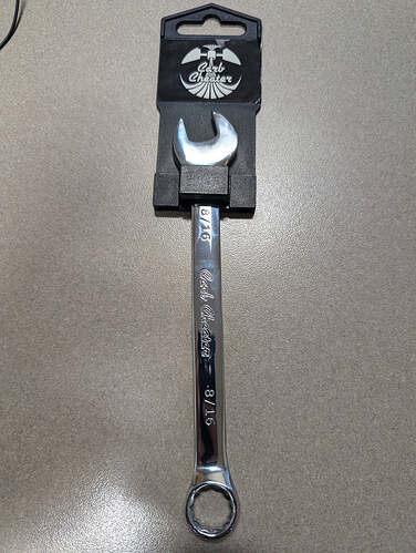

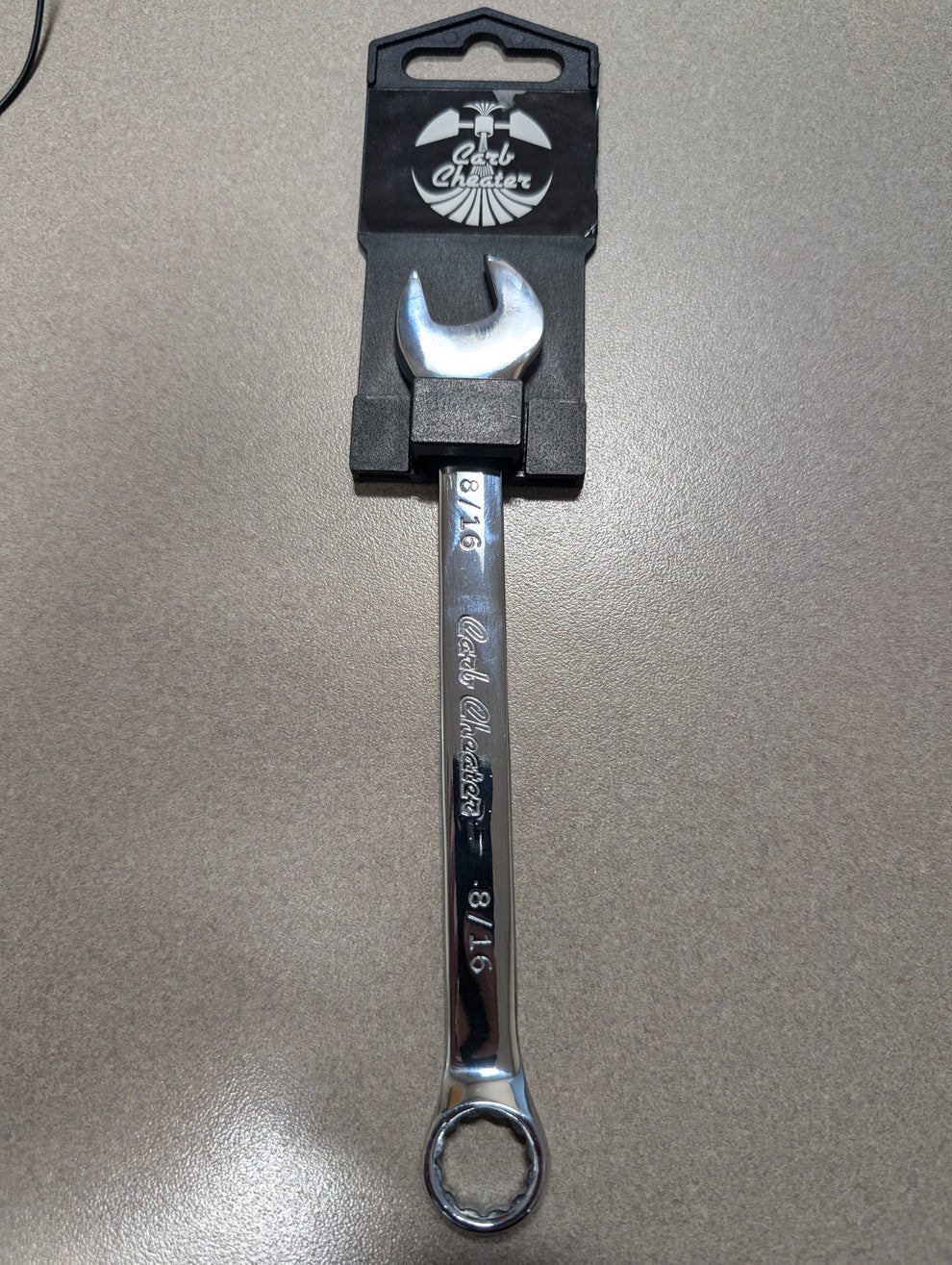

A 8/16 wrench may help you with this repair.
