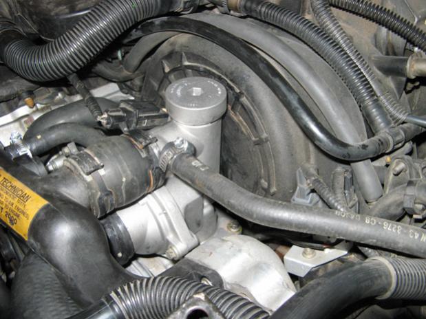

Here’s what the degas bottle looks like and Tardis correct about this being the cause of the overheating.

It is not an overflow bottle. It is a pressurized (the radiator cap goes on top of it) reservoir with some internal plumbing to remove air from the cooling system, that’s why it’s called a degas bottle. Cracks prevent the cooling system from pressurizing and allow air to get trapped in it.
They crack after some number of hot/cold cycles.

The degas bottle is a common cause of overheating.
If yours is more than five years old, it is certain to be cracked.
Here are instructions on the correct way to bleed the cooling system after replacement.
