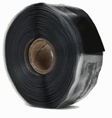

Glue won’t work. Try silicone repair tape. It’s made for jobs like that and is heat resistant to 500 F.
Don’t use anything that contains silicone unless it states it’s sensor-safe.
Ordinary silicone will damage O2 sensors as it off gasses and gets pulled into the engine.

I’ve been using silicone tape for all kinds of applications since 1971… when I first became familiar with it. We used it in the Air Force to wrap repaired wiring harnesses on our B52 bombers. It’s almost impossible to find in civilian life, but I just discovered that WalMart now carries it in their automotive department. In its tape form, outgassing will not be a problem.
It’s fun to use. It stretches and sticks only to itself, there’s zero adhesive, and it sticks tenaciously to itself for all eternity. Once it’s stuck to itself you’d have difficulty unwrapping it. I’ve tried many times in the past and always had to cut it off.
However, if there’s deterioration of the hose and/or mechanical stresses that caused the breakage, it should only be considered a temporary fix. It’s not strong mechanically, and, like all elastomers, it will cold flow (stretch and move due to the mechanical stresses) over time. You might want to browse the shelves at an auto store, or even a big-box hardware store, to look for a permanent replacement. OK4450’s heater hose idea is a good one if you can get it to kit over the ends. Avoid polyethylene, like the clear fishtank hose, as it will be attacked by the hydrocarbons in the crankcase fumes.

I find the largest piece of tubing that would fit inside, then tape (silicone tape sounds good) the two ends together with the tubing inside.

Keith, I suspect you’re right about the lines. Dedicated designed parts not intended to be inventoried en-masse in the repair parts chain are generally very highly priced. The more I think about it, a short piece of thin-walled aluminum tubing properly sized with a silicone tape wrap, or even heat shrink of the outside, just might effect a permanent repair. It’s what I might do. I’d use the silicone tape. Personal preference. I like silicone tape.
