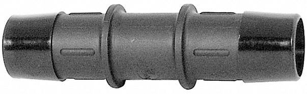

I want to remove a steel line and substitute a rubber or silicone hose (which is preferable for a tight area?).
Was going to pull out the steel line and use something like this as a transition to the existing formed hose at either end: http://imageserver.grainger.com/is/image/Grainger/5NDF6_AS01?$productdetail$
I think that calls for a single, lined worm gear clamp at each end.
It’s defying the engineering. Was hoping someone’s familiar with this… and if it’ll work out OK.
