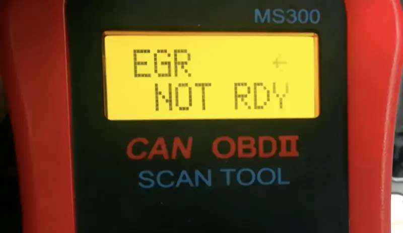

I bought a scanner, the Innova 5010. It’s a code reader, but from a reputable company. All I/M monitors completed except the EGR. It’s flashing at what I think is a slow rate, meaning that it’s not complete. There are no DTCs. Suggestions?
“When a Monitor icon is flashing red, it indicates that the vehicle supports the associated Monitor, but the Monitor has not yet run its diagnostic testing.”
I’m assuming that’s your situation? The “EG” led is flashing red?
“MONITOR STATUS - If the Code Reader’s LCD display shows a zero (indicating there are no DTCs present in the vehicle’s computer), but the yellow LED is lit, it indicates a “Monitor Has Not Run” status. This means that some of the Monitors on the vehicle have not yet finished their diagnostic self-testing. This condition is confirmed by one or more blinking 6 Using the Code Reader CHECKING FIRMWARE VERSION - ERASING DIAGNOSTIC TROUBLE CODES monitor icons on the LCD display. A blinking Monitor icon means the Monitor has not yet run and finished its diagnostic self-testing. All Monitor icons that are solid have completed their diagnostic self-testing.”
Sounds like you’re either not meeting the requirements for the EGR readiness monitor to run to completion . . .
