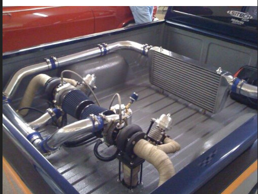

On a vehicle where emissions is not in question for whatever reason, you can place a turbo anywhere in the vehicle you choose, a lot of drag race trucks install the turbos in the bed area of the truck, I have also seen turbos installed at the very back of the vehicle…As long as you have exhaust gas spinning the turbine, it will work…
Yup. I’ve seen twin turbos located aft of the rear axle. It was a plumbing nightmare.

Talking about remote turbo installation:
Probably not really doing its job located there. Take forever to get up to temp if it ever does unless the engine is running super rich and even then…exhaust gas has cooled quite a bit by the time it gets to the muffler in a pickup.
