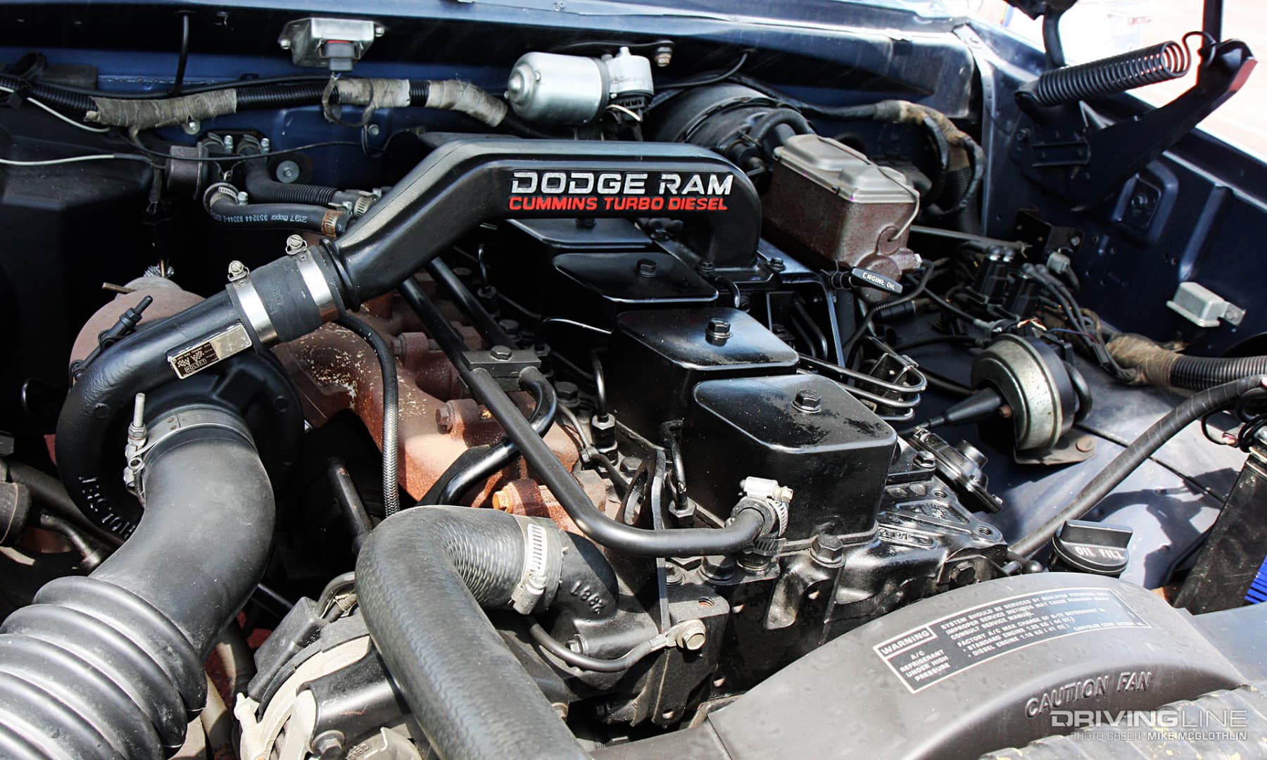

Catalytic converter replaced with turbo

It seems to me that the farther away from the intake manifold the turbo is, the greater the pressure loss. Distance and additional tube bends would reduce efficiency.
With turbo chargers 10 feet from the engine, it would take a moment to fill those long pipes with air pressure, I wonder if that was understood before the project began.
This is a nice direct path to the intake manifold, the first few years did not have an intercooler.
