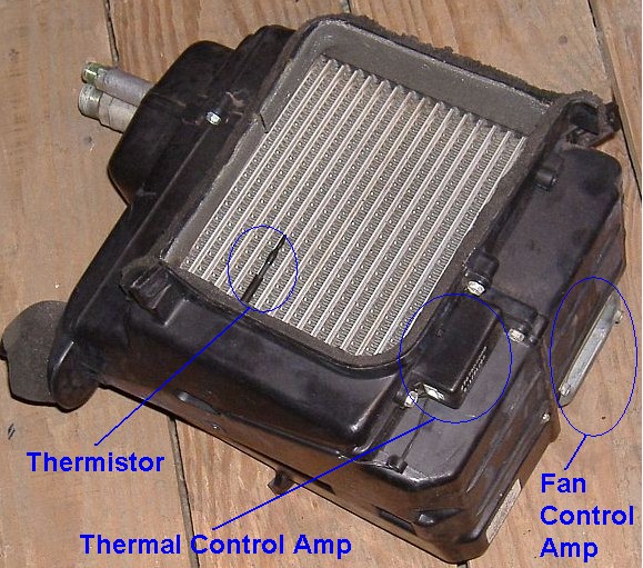

One possibility is that the evaporator coil is icing up.
Yep, and it might be the evaporator thermistor and thermal control amp:

Thermistor sounds compelling. I’ll keep y’all posted
