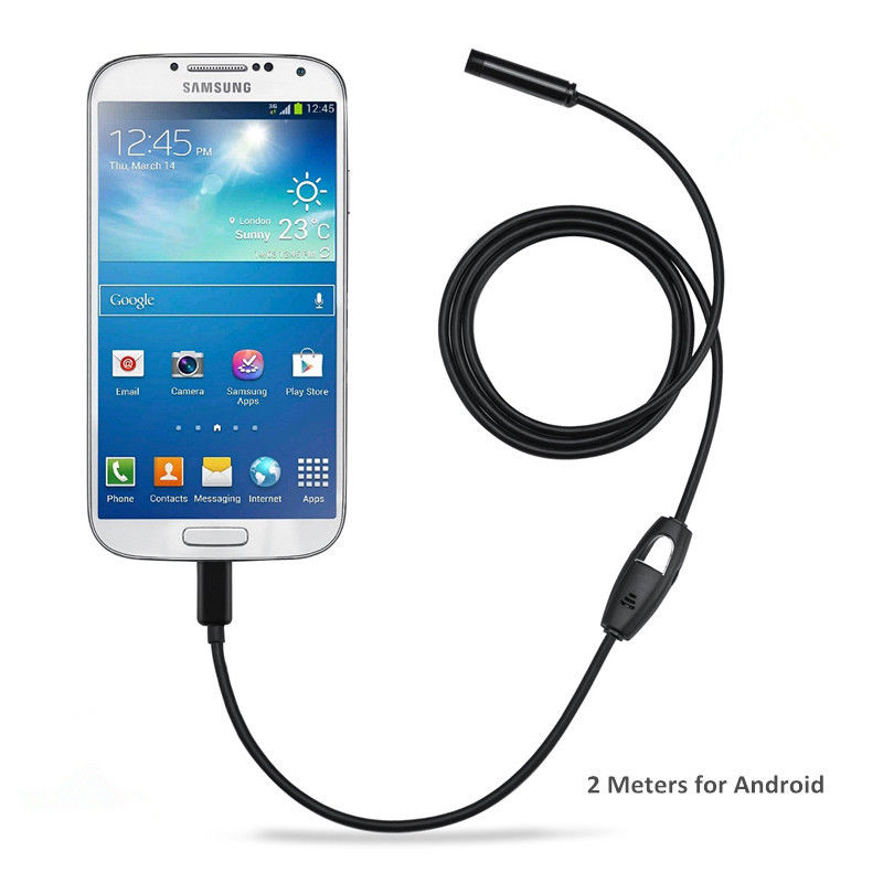

to inspect insides of cylinders, you can get something like this:
tried that toy myself: quite amazing what you get for $10 nowadays

I’ll give that camera a shot and check out those cylinders, thanks

with camera you would likely be able to confirm that by having a lot of deposits in the pistons and valves, your spark plugs are very suggestive in this direction

get you piston tops examined with an endoscope, it will probably give us new set of clues
