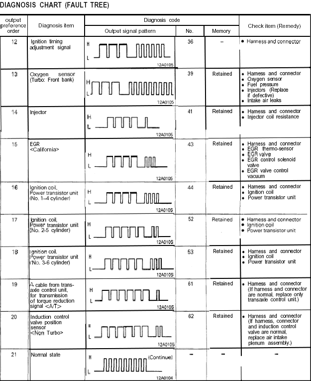

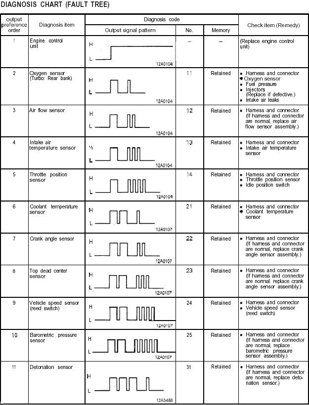

Are you still having trouble getting the flash code? Grab out your analog multimeter. Set it to 10VDC
The diagnostic connector is where the fuse box under the driver’s dash is. Attach the positive lead to terminal 1 (top left as you’re looking at it from the seat), and the negative lead to terminal 12 (bottom right). Flip the key to on, and read the needle blips. The pulses are the code. Here’s the decoder ring:
Take a close look at the spark plug boots, I have found holes burned through the boot near the top of the spark plug. The spark jumps to the spark plug tube.
You can rear fault codes with an analog volt meter;
Connect an analog voltmeter to the ground and self diagnosis output pin of the diagnostic connector.
Set the ignition switch to “ON”.
Note the pattern of pulses displayed on the voltmeter. If the voltmeter indicates a steady 12 VDC the ECU has failed.
Example; code 13
The needle will deflect one time for approximately 0.5 second. This will represent one unit of ten. There will be approximately a one second delay and then the needle will deflect three times for approximately 0.2 seconds with 0.1 second delay between deflections. This will represent three units of one.
