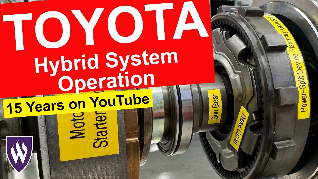

Maybe this will help some…
And for haha’s, here is the new(ish) i-Force Max hybrid system…
At about 205 volts, working on a Prius hybrid battery is best left to the pros too.
True, but it’s self-contained and is designed to be be removeable, with a “service plug” that, when pulled as a first step, disconnects the cells from the terminals. I wouldn’t disassemble one, but I might remove one.
More, if you’re curious:
