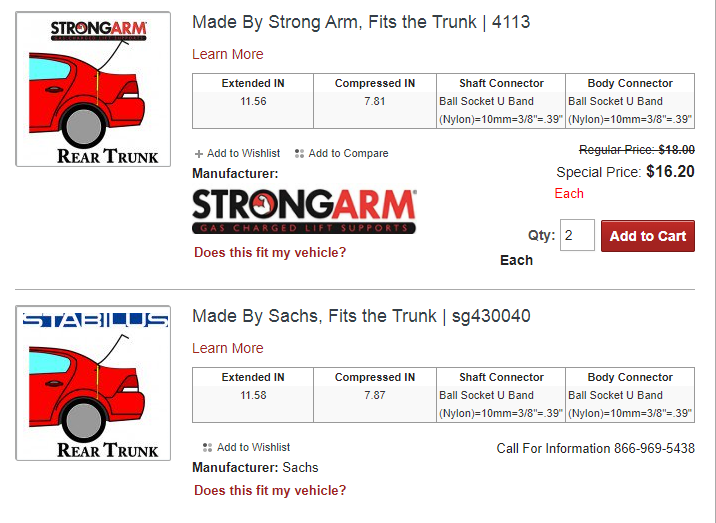

thus far, they offer for this model
one or two listed under consideration at Rock Auto .com
OK, off to order AMS AUTOMOTIVE 4113 "100# of lift"
the most of the only TWO that offer this to blind shoppers.
