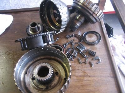

Transmission went. TOTALLY went… gears are completely stripped, pump is shot, etc. Apparently it cannot have a rebuilt transmission put in; it needs a new one. Another CHRYSLER transmission.

I’ve been told by a few mechanics now that Chrysler T&C’s are notorious for faulty transmissions. I’ve been told by 2 mechanics that the gears are completely stripped and the pump is blown. When it broke down on the highway, it wouldn’t even go into park…my son had to keep his foot on the brake the entire wait for the tow truck’s arrival. That’s b/c the gears were shot, gone, stripped down…from what 2 mechanics have told me. However, whether or not it’s specifically the Chrysler T&C’s transmissions that are ‘special’ or whether it’s all minivans transmissions that are ‘special’ is a moot point here. What matters is spending a lot of money on another ‘special’ transmission that’s going to go.
