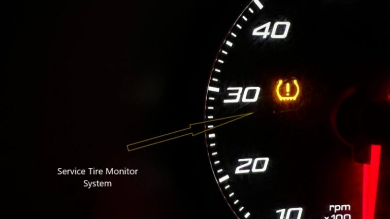

2017 Chevy Colorado. So the low tire pressure warning lights up on my dash and I get the message to “service tire monitoring system”. I check the tire pressure screen and one of my tires is no longer registering (even though it is at full pressure). I think to myself, I will just get that TPMS sensor replaced next time I rotate the tires.
Well…about a week goes by and I check the tire pressure screen again and now two of my tires are not registering. I have tried relearning both of the tires with the TPMS tool and that does not work. I also checked for any error codes and my truck is not throwing any. So here’s my question. Is it more likely that the TPMS sensors on two tires both coincidentally died within a week of each other? Or is the issue more likely to be something going on with the whole system? Thanks!
