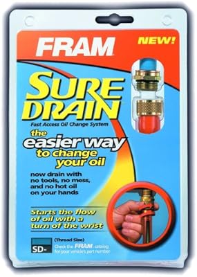

This one works just fine for me. I have these on all the machines I maintain, including both motorcycles and the manual transmission on my car.
I also have no financial interest in this item.
The biggest advantage of using one of these is that the piece you screw on to open the valve has a hose attached, eliminating oil burns and greatly reducing spilled oil. I also don’t have to buy any crush washers anymore. In fact, on one bike and one minivan, I don’t even have to jack them up anymore to change the oil.
I’ve thought of maybe using these things before & I’m actually getting tempted now. I guess I’ve just always hesitated since, if the spigot is that easy to open …
