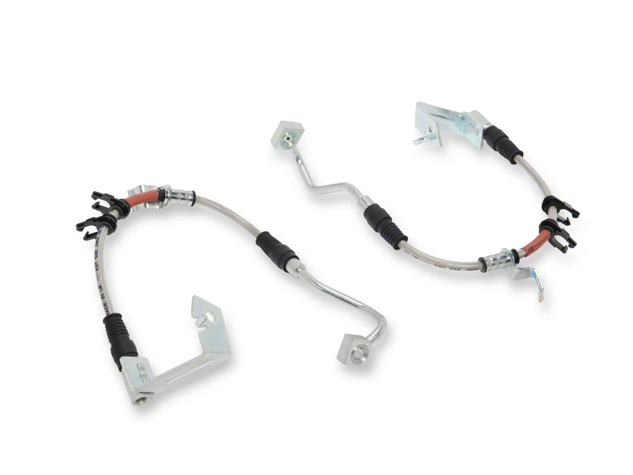

How do I know it’s the braided brake line that connects to the banjo bolt that’s gone bad or if it’s the entire line that connects up to the master cylinder that needs replacing when I search for “2013 mustang gt brake lines” it only shows results for the lines that are about 6 inches- a foot long that connect to the banjo bolt, not the long plastic lines that connect to the master cylinder? Or do those ones not really get clogged/go bad?
I’m talking the brake hoses to the brake calipers.
These are the hoses that get flexed all the time and are prone to breaking down inside.
These ones right?
Those aren’t stock brake hoses.
So, I don’t know their construction.
But I see they come with a 3 year warranty.
So, you got that going for ya.
