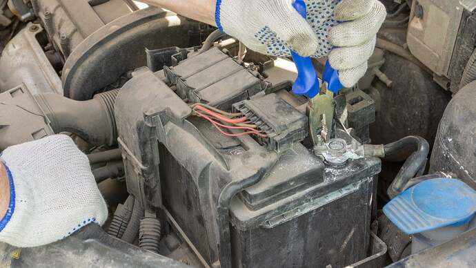

I’m talking about for long-term storage.
Whoever removed whichever cable when I was gone for 6 months because the horn/alarm started blowinging by itself randomly only loosened the kreldan thing, but left it on the terminal post. When I came home, the battery was completely drained and I needed to have AAA come and jump it.
So I’ll ask again: in a future such scenario, long-term storage, not a jump-start, but for future long-term storage, which cable should I remove?
The answer stays the same, unhook the negative 1st and hook back up last…
Once the circuit is broken the circuit is broken, the only thing you can/might have from there is a surface discharge…
Thanks.
And for my purposes, only the one cable(negative)?
I should have picked up on that based on the fact that on 2008-12 Accords, there is no slack around the positive cable. Negative cable? Enough slack to stow it decently far away from that post.
I’m admittedly as ignorant a member of the general public about which battery cable to remove for any purpose, as I am knowledgeable about tire pressures!
Your welcome sir..
Neg removed will be fine as far as the vehicles electrical system goes, but for long term you might disconnect both (still neg 1st) to keep corrosion down on the remaining (pos) cable terminal, or just clean the battery, terminals and post really good with very hot water (w/ baking soda) and then apply a thin coating of dielectric grease to the terminals… Works great in my area anyway…
I don’t really see the advantage of removing the battery cables on a modern car during storage. The battery has internal resistance and will self-discharge over time even if disconnected. It has to be periodically re-charged regardless. Disconnecting it just extends the interval a bit. In a properly functioning car, the keep alive drain should not be so high as to warrant removing the battery and in many cases, the side effects of removing power may be more onerous than the slightly more frequent charging interval (e.g. entering security codes, battery status that may require factory tool, certain presets etc).
I have a schedule on my calendar during winter months to re-charge batteries in stored vehicles/boats etc. so I don’t forget.
I am an electrical èngineer. Disconnecting either terminal breaks the electrical circuit and the PCU has to recalibrate when you start driving again. Disconnecting the ground terminal is a little safer JIC someone carelessly drops a tool on the battery and shorts the positive terminal to the car. When removing a battery disconnect the ground terminal first. When installing a battery connect the ground terminal last.
The battery will last longer if it is kept fully charged and not overcharged.
