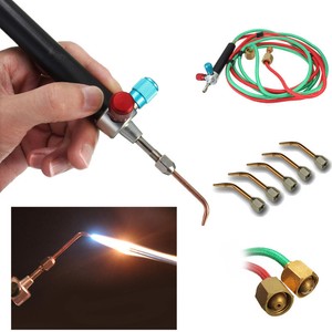

The hot wire is made of platinum.
In order to solder platinum requires a jewelers torch.
A soldering gun/iron doesn’t get hot enough.
If you can solder that wire without melting the plastic of the sensor, you’re a better metal joiner than me!
And it also changes the resistance of the wire.
