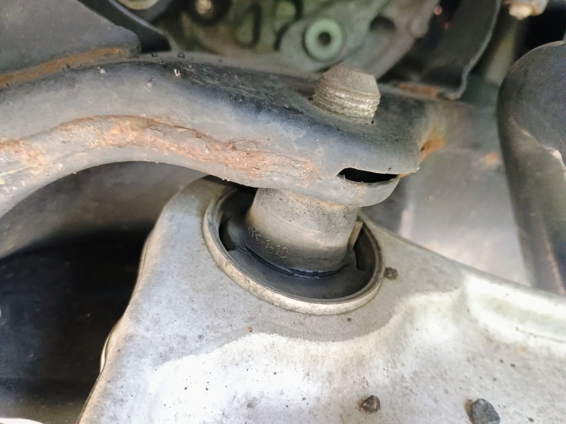

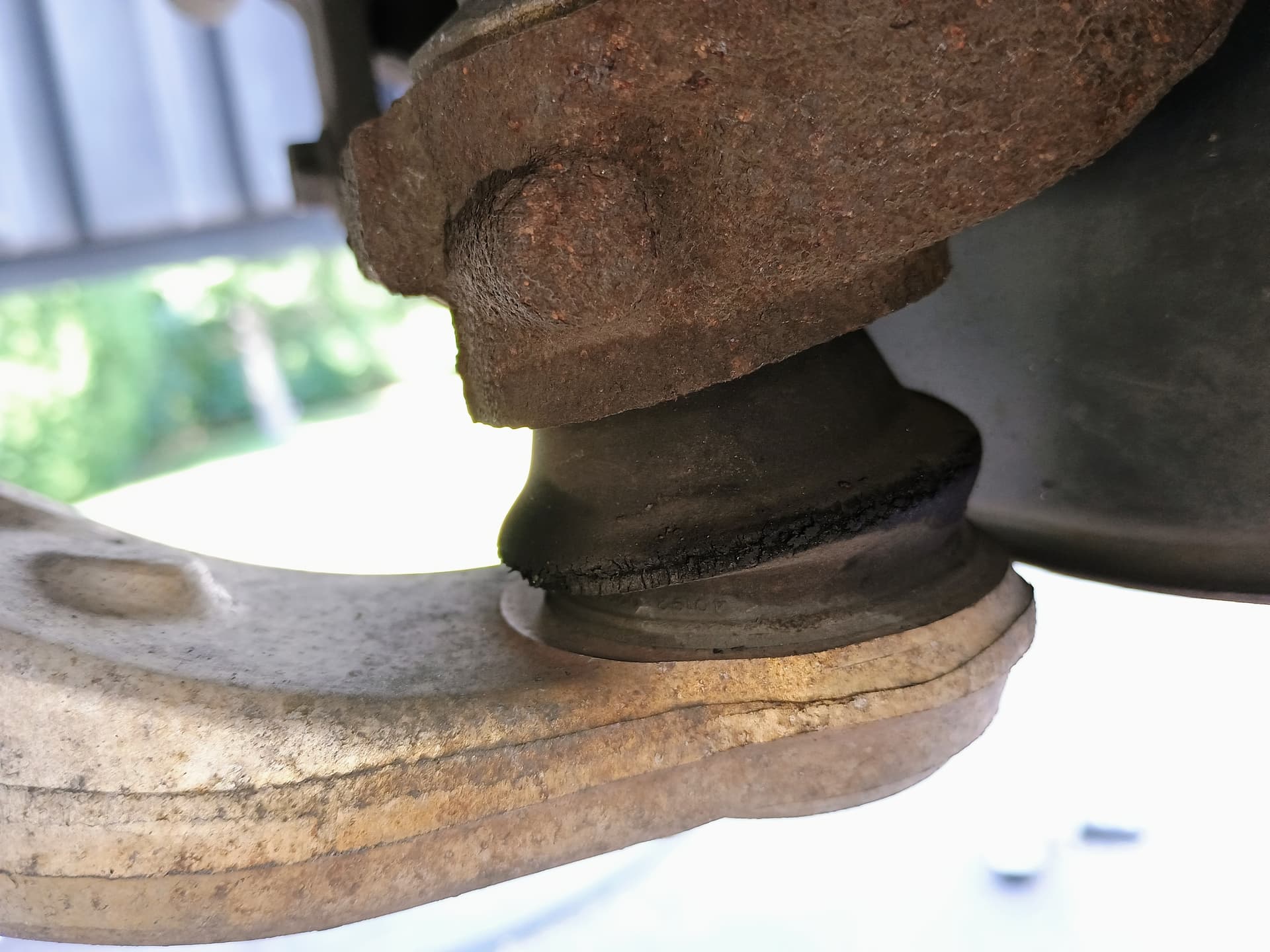

I noticed that the LBJ on this car, the rubber boot was torn around the circumference of the boot, looked like rubber dry rot. This is both sides.
There is no grease coming out. There is no squeaks when rotating the steering wheel. Upon pressing into the boot it deflects some with some resistance, so I believe there’s still grease within the boot. Should I bother replacing these lower ball joints at this point, or just wait for grease to come out, or symptoms of squeaks when rotating the steering wheel?
Additionally, I noticed the horizontal bushing for the LCA, has a giant crack in it. The other side is not too bad, but also has as crack. There is no loud thud when going over bumps. Should I also just keep an eye on this. The first image is the one with a rather large tear/crack in it, the other side is the second picture.
Thank you!
I’d wait until the ball joint(s) started making noise or if it started effecting the steering or tire wear is noticed.
Then relace the control arm assemblies.

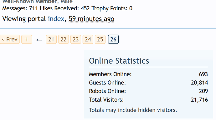

I do see LCA & UCA being used all the time on another forum I am on that as of this posting, has had 693 current members online in the last 59 minutes, lots of talk about suspension lifts and what nots… They even use AAL (add a leaf) a lot referring to adding leaf’s to the rear leaf spring packs…
