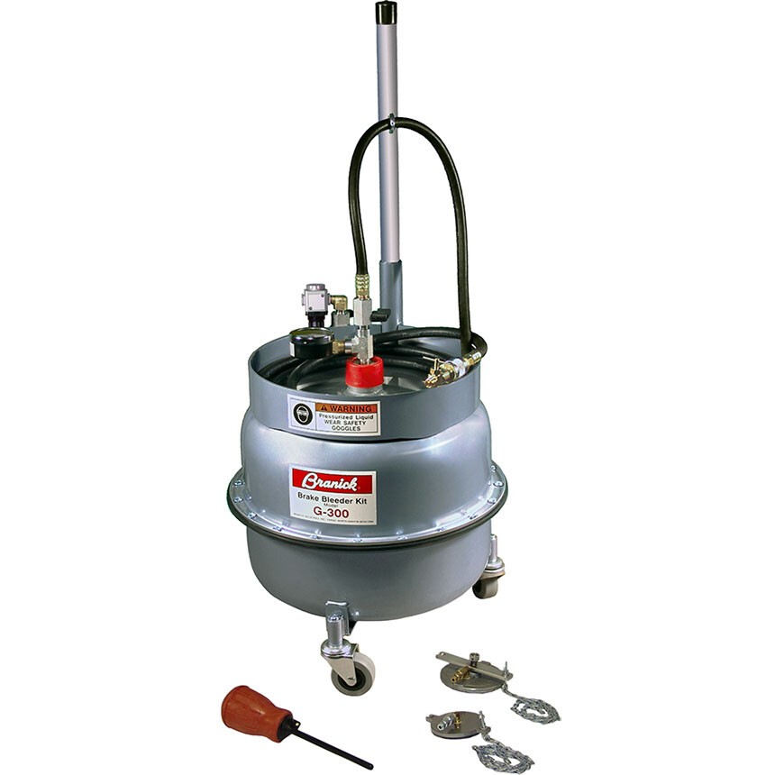

When a shop replaces the brake fluid, they use a brake fluid flush device that replaces all the brake fluid.
And when they replace the coolant, they use a coolant flush machine.
Both these methods replaces all the fluid.
