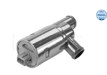

I have a Peugeot 405 1.9 SRi and I’m having issues with the idle air control valve (IAC valve). Unfortunately, I haven’t been able to find the exact same part in the market.
I’ve attached a photo of the current valve from my car. I’m also including a photo of another similar-looking valve – could this one be compatible?
Any help would be appreciated. If you know a compatible part from another model (Peugeot, Citroën, or others), or an aftermarket solution, please let me know.

That type of IAC is not common in the states. Ours usually screw into the throttle body. Seems like this one is a simple bypass valve. If you can connect the bypass hoses, I think it might be made to work. I notice the “new” one has 2 electrical terminals? Does your Peugeot IAC have only 2 terminals?
I think these work by sending voltage pulses to the terminals to screw the valve in or out to open and close the air passage. That would mean to close, the one terminal getting positive voltage is not the same as getting positive voltage to open. The polarity will switch depending on the need for more air or less air. If both valves originally came from the same supplier and each have only 2 terminals (and even better, the same connector design) it may work.
Assuming the new(er) one is functionally identical and has the same electrical connector, I’d be tempted to use it, with a self-fabricated bracket, rather than scouring the ends of the earth for a part which may no longer be obtainable from any manufacturer

I have seen an IAC that looked like that on a Euro many years ago, maybe BMW but don’t remember the details, I do remember that it had a very high idle (stuck open) and it was either not available (no googling back then) or it was stupid expensive, so we simply beat a piece of wood in it and started small and drilled a hole in the center of the wood stepping up in size a little at a time until we got a good idle speed, was it perfect? no, did it work? Heck yeah it did… Sometimes ya gotta do whatcha gotta do… Now a days, there are probably better materials to use than wood…

The idle air control valve in your second picture is the same as the replacement IAC shown in the parts catalog for Peugeot and other European cars.
