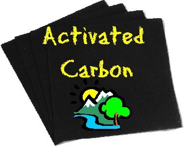

Then air it out as above. Still smell it? I’'d try some kind of activated charcoal air filtering scheme, like a 20 inch box fan with an activated charcoal filter over the inlet, letting it run overnight in the car.
I’ve never had the need to try this myself, but maybe something like this
