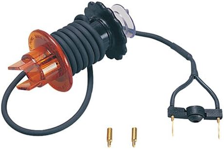

The next thing to check is if the the computer is grounding the circuit for the #2 injector. This can be done by plugging in a noid light into the connector for the #2 injector to see if the noid light flashes.
