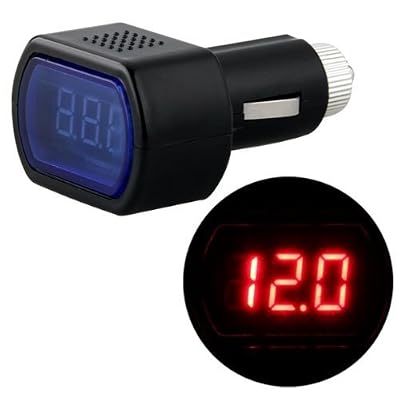

Get a 12V digital meter to plug into an accessory receptacle:
It should read over 13.5 volts when the engine is running. (Remember to remove it if it doesn’t turn off with the key out.)
