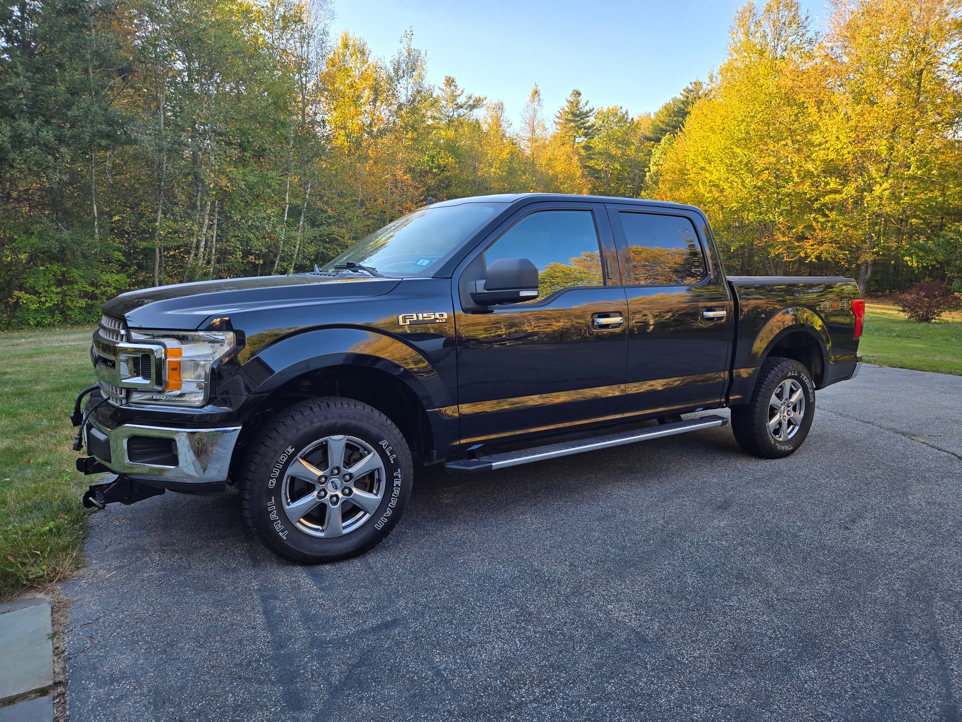

So, just to follow up, I bought the truck. Got a very good deal on it especially considering it also came with a 4 year old plow.
It’s an XLT Supercrew w/optional 5.0L, 10R80 and factory tow package. That is critical info for the next paragraph :smile:
Ran into the first issue. Noticed some drippings on the second drive with it and on the next drive, it was a significant leak. Small puddle pretty far back from engine compartment so crawled under to look. Coolant. Not being familiar with Ford, I initially thought it must be for a rear seat aux heater. Nope. It is a hard line for the transmission “cooler”. They pipe coolant to the cooler adjacent to the transmission. One of those lines is severely corroded but the all others look pristine. Prior owner tried to hide issue with some spray on undercoating. :face_with_raised_eyebrow:
Now for the fun part. Good luck finding that specific line, online. There are variants for the various configurations. That is after you even find the details for the factory towing package. At one point, I’m under there and see the good line still has the factory part tag on it. Viola! (sic). Fortunately, I get a clear pic of it taking the shot blind. Nowhere to be found online. I did uncover a series of super-cessions to a new part number that matches the line. Yay.
This is a good point- I usually remove those tags when doing my own work. From now on, I’ll leave them there for the next person!
Now the fun part. I get the line disconnected but there is absolutely no way to remove it without pulling the axle or removing a cross member. Neither of which is looking like fun. The line is also $100 with significant discount. So I’m thinking, why not cut it in half, trim it up and install a section of heater hose to replace the corroded section. The rear end was already a hose going to the cooler inlet. Found some nice silicone heater hose for high(er) temp applications and used the forward section of the line with the “quick” disconnect. Another cruel joke BTW. It is neither quick or easy to disconnect even though I have a tool for it.
You might ask, why not take it back to the selling dealer and make them fix it? Well, my experience is not good with such things, They tend to do lousy work when forced to spend money after the sale. Or find lots of other things to jack up the repair to offset their part of the cost contribution to fixing it. I may go back and present them with the cost of the parts and ask for them to split it with me. Good deal for them considering it’s my labor and a lot less expensive than the OEM line…
You have just found out precisely why I’d rather buy an old vehicle with high miles for a cheap price, versus buying a much newer vehicle for a lot more money at a dealer. The reason is because unless you are willing to pay close to MSRP for a “certified” model, both options have the same warranty (i.e. none), and both will require you to spend money and effort on repairs and deferred maintenance. In fact,buying an old truck with over 200,000 miles has been quite the bargain for me. I paid about $2k for it, and spent about $2k on new tires and other repairs when I bought it, and drove it without any major expense until earlier this year when I paid about $3k to rebuild the suspension and replace the steering rack. How much would I have spent on loan payments on a newer used truck over the past 5 years? And what about repairs and maintenance?
Just found out? I’ve been buying used vehicles for 50 years! and fixing them myself to boot.
It’s a crapshoot with any used vehicle. I go into it with my eyes open understanding that things will crop up and no matter how experienced or diligent you are, stuff is just going to happen that you may not have anticipated.
For the most part, I’ve come out way ahead buying used stuff. I have bought a number of new vehicles as well. There’s a lot to be said about the peace of mind and other hard to quantify benefits of owning new as well. I could have went and bought a brand new truck cash outright, but I’m old school in some ways and $50k-$70k for a truck is not going to happen for me…this is my replacement “beater truck” :wink:
a great buy and a nice truck. I’ve looked occasionally and dealer lots have had some trucks that make the ones for a little more money look good.
Nice looking truck, congrats sir!!!
Car I got has new radiator. And trans cooler line had seepage at fitting. After tweaking fitting I found rust pin hole in line under new radiator. Seems touching an old line is not good.
By the same token, if it is compromised enough to start leaking after it has been handled or disturbed, then it was probably destined to fail on its own pretty soon anyway. I’d rather find it at a time of my own choosing than to have it fail at a later date that might not be as convenient. Sucks either way but one is less sucky :smile:
