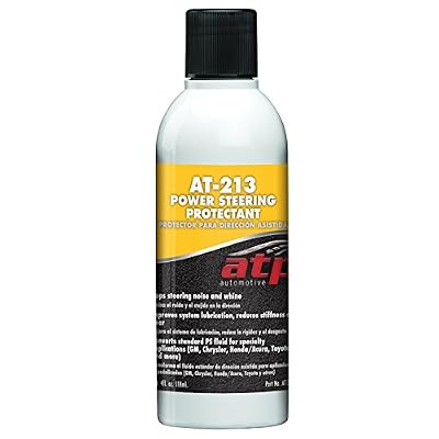

Ford dealers use this a mechanic in a can product to help with noise complaints.
