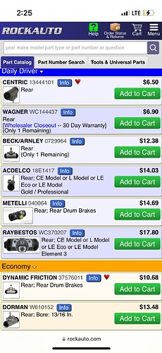

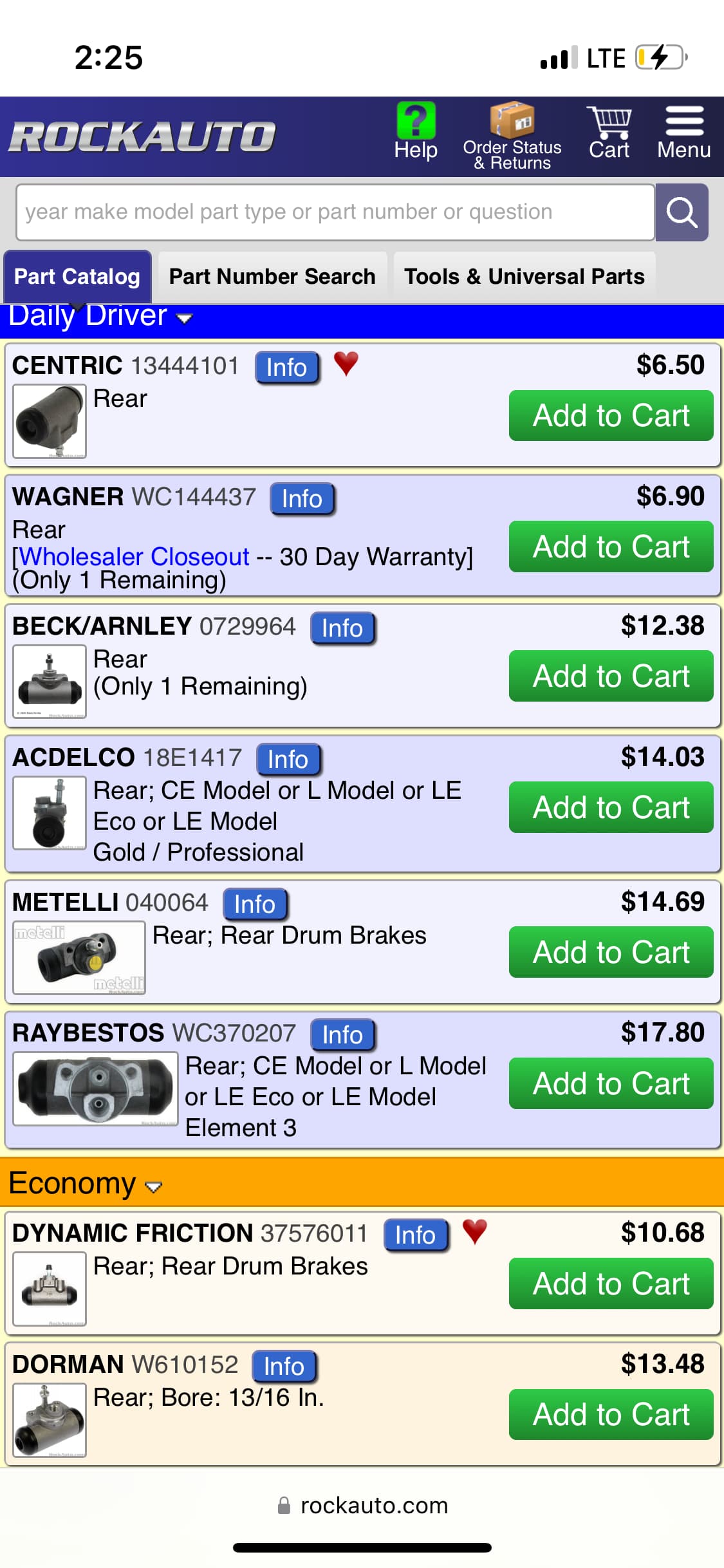

I purchased raybestos wheel cylinders for my rear drums on a 2015 Toyota Corolla. The OEM ones were over $60 each where the raybestos was $17. I am mainly concerned about leaking. As anyone had experience with raybestos wheel cylinders? Part number is WC370207. Thanks

They are from rock auto. The oem has lasted 180,000 miles and I am replacing the rear drums and shoes and hardware. I would want these raybestos to last another 180,000
