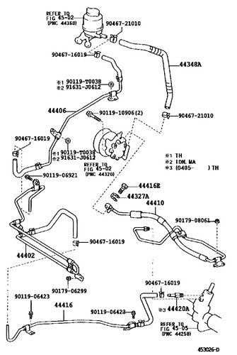

Hi, friends. Anyone know which of the two hoses on the power steering reservoir is the return line? I need to change the fluid in my 94 Camry with the 2.2 l. Alternatively, is there an easy way to differentiate between return and suction?
The big hose at the very bottom of the power steering pump Reservoir is the feed line to the power steering pump, the smaller raised line is the return line from the rack-n-pinion or cooler (been a while)…
Number 44406 is the return line/hose…

Depends on your question and perspective.
44406 is the return line to the reservoir.
44348A is the return line to the pump.
That is the direction of flow, from the rack and pinion to the reservoir, then from the reservoir to the pump.
