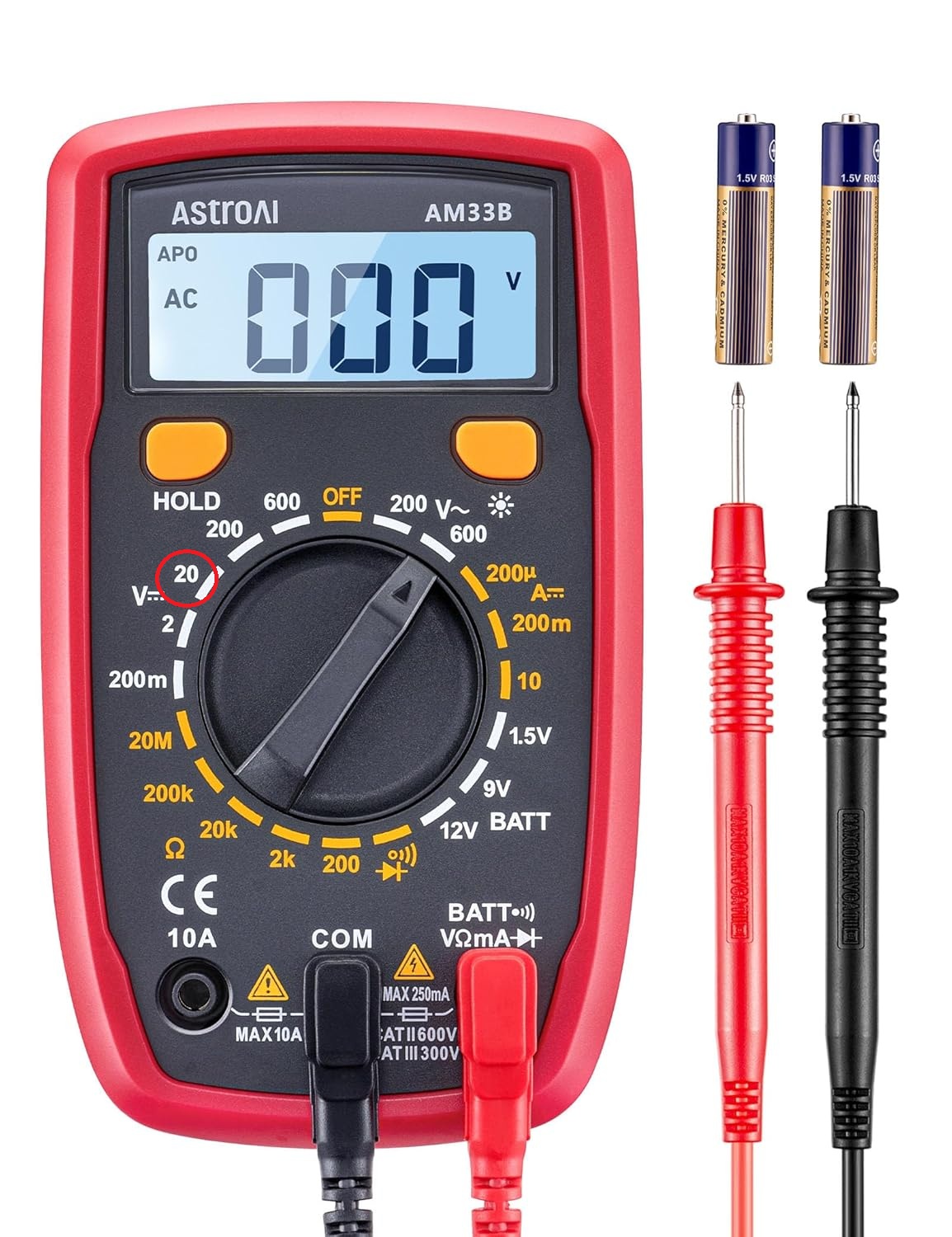

I have an Astro AI multimeter, and it looks different idk if it has that function.
This scale on you meter measures for 12 volts DC.
