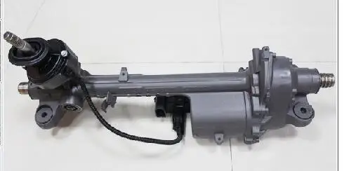

Your Tiguan has electric assist power steering.
So it could be the motor on the rack& pinion assembly.
