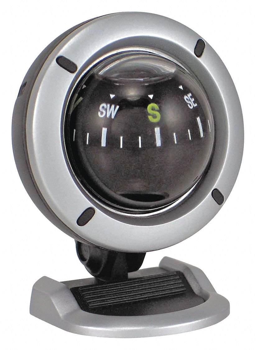

First of all they might be correct it will be expensive . Now Google is your friend . Amazon has compasses that mount on the dash for a lot less the repair bill would be. There are also replacement mirrors for sale.

A dash compass works if it’s installed correctly.
The first thing that has to be done is a base reading.
Take the compass and get a reading away from the vehicle and away from any metal…
That’s the base reading.
Take the compass and place it on the dash and level it.
Start the engine and turn on the blower fan.
Rotate the compass until it points to the base reading and secure it.
That’s it!
