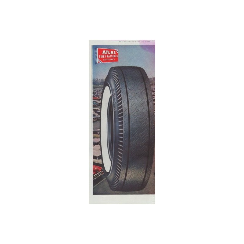

texases- They were Atlas Bucrons, super sticky rubber compound with only two tread groves to make them street legal. Wouldn’t squeal and were fantastic in the rain.
Look like this?
Thats it! Funny I can remember that, but not what I went to the next room to get.

Fantastic in the rain? Unusual for cheater slicks.
Those old Atlas Bucrons made the best 'Cheater Slicks" at the drags…
