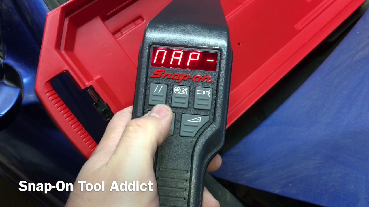

I have a snap on timing gun it umm basically digital. I set it to 12 and line up the distributor to the red mark in the pully.
What your saying I should leave the gun at 0 and line it up with the red mark ?
This is the thing I use. image
Suggest to let someone here who has actually done ignition timing on your engine weigh in on this. I’m not familiar with that timing light, nor which marks mean what on your engine; but I do expect that timing light setting is where the confusion is happening. You might try what you did before, but this time setting the timing light at 0 degrees, see if Honda’s ignition timing check directions make more sense then.

To check the timing there’s a setup involving the SCCS connector. Next, there’s two marks on the crank pulley, one red and one white. And a pointer attached to the engine timing belt cover. The white mark corresponds to tdc, the red to 12 dbtc (or 16 if you have that version of the engine). With your timing light knob set to zero degrees, (or with the type of timing light most of us diy’ers use without the advance/retard knob), the pointer should line up with the red mark at idle rpm, warm engine. If you dialed in 12 degrees advance on your hi-tech timing light, then the pointer should line up with the white mark.
Thank you so I set my timing gun to 0 and line the red mark to the pointer?
Yes. That’s what the info I found says.
