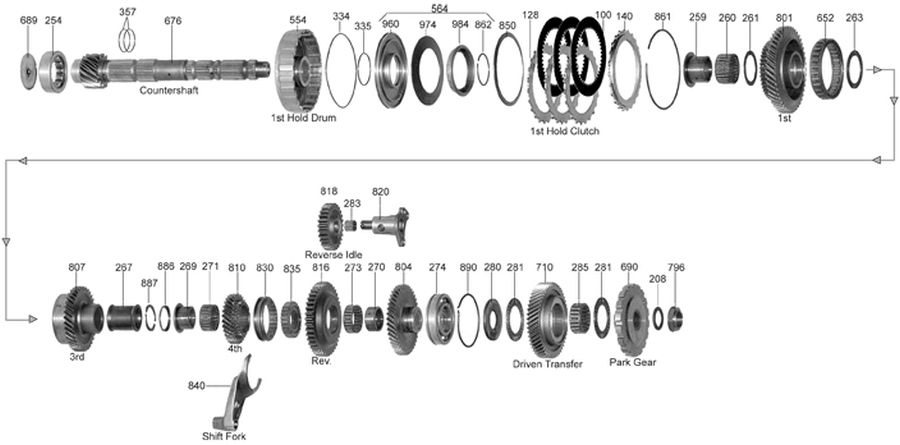

Here is the APX4 version of your trans…
https://www.wittrans.com/img/diagrams/85/85.jpg
And the countershaft with reverse gear, rev idler w/bracket and shift fork…The parts may no longer be made or hard to find, so you may need to go with a good core and make one good one… But Honda’s are very popular, so the after market may have picked them up…
https://www.wittrans.com/img/diagrams/85/85_countershaft.jpg
