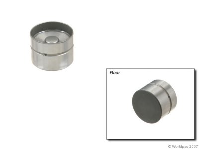

It’s a lever that rubs against (“follows”) the cam and pushes the valve.
This is what a Eurovan cam follower looks like. It’s the bucket that a cam lobe operates a cylinder head valve with.
http://images.apwcontent.com/is/image/Autos/w0133-1635350_is?$APW_imgProd$
Rattling lifters points to faulty lifters (cam followers), worn cam lobes, or an oil pressure problem.
In most cases, worn cam followers means the cam lobes are worn also.
Properly done, wear on the cam followers or cam lobes means both are replaced as one has an effect on the other. Worn followers/new cam = prematurely worn cam. New followers/old cam = prematurely worn followers.

Your Eurovan should have hydraulic lifters. This means there are no shims and no adjustment is necessary or possible.
