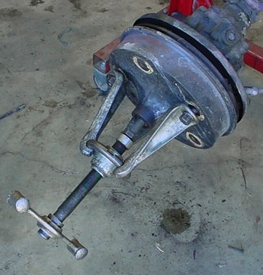

This Drum Puller tool has worked well for me. Some of the FLAPS rent them out but they aren’t too crazy expensive if you do your own brake work. Those hammer heads allow you to bang on them with a baby sledge, making short work of pulling them off.
Isn’t that a rear brake/axle RemcoW? It’s the front brakes that are frozen. .

Ah, I missed it was just the fronts.
Yeah, the rear is usually worse. I got a new rear (well, ‘old’ but new to me) for my 52 truck and wanted to clean it up before I bolted it on. It hadn’t moved since the 60’s, I was told.
Besides being splined, it is also very much tapered so it was fused together. It sprayed a half a can of Kroil in the joints and let it sit. Even then, it took me two days after work of smacking it with a sledge to get it off.
I started with the impact gun, then a baby sledge to then bring out the really BFH, half out of desperation and the other half pure anger, . It was scary when it finally let go, its swan song being a really loud “CRACK!”. I thought I had snapped my tool. Make sure that axle nut stays loosely on the end of the shaft so the drum and puller don’t go flying across your garage.
