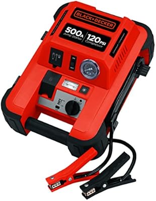

You can also kill two birds with one stone by getting a power pack for jump starting your car in case of a dead battery, with a built-in tire inflator. I have one and use it frequently to top up air in my car and snowblower tires. The nice thing about this is you don’t need a 12v outlet nearby.
