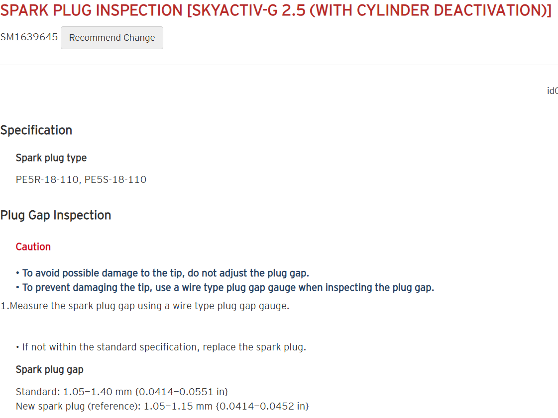

The word out there now is that checking and regapping spark plugs done incorrectly can damage the platinum or iridium tips and lead to a misfire that wasn’t there before. So, if you do choose to do so, check the gap with a wire-type gauge. If the spark plug gap is out of spec, replace the spark plug.
If a brand new spark plug of the appropriate part number fails the above inspection, it is defective and should be replaced under warranty.
But there are people who use Autolite spark plugs in everything…
My Honda 2010 Accord 4cyl gap spec is 0.044”/1.1mm, towards the low end of the range in your provided illustration.
So is that counter person correct in saying I don’t need to touch the gap?
I dunno. Where were you buying them? What kind of plugs were they? What I posted was a cut and paste directly from a Mazda Factory Service Manual. It clearly states to check the gap and replace the plugs if out of spec. If you were buying the part number specified in the manual from the dealer it was manufactured at the proper gap. If it was damaged in shipping or otherwise faulty, it should be replaced.
If you’re using plain copper-core spark plugs, gap to your heart’s content. Platinum, sure. But iridium? You can damage the iridium tip if you pry against it to open up the gap. So were the plugs out of spec and if so, which way?

It’s a bad practice to pry on the center electrode of any spark plug IMHO. The gapping tool should only engage with the ground strap to adjust the gap. Yes, an Iridium electrode is very brittle and can be damaged by pressing against it but to say you should return the plug because it is out of spec is extreme. Learning how to properly gap plugs would be a better solution.
