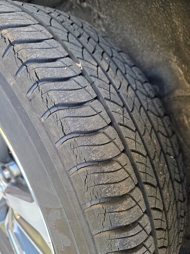

OK, tires looked ok for a while, no indication of other maintenance in the list in the manual. Maybe new tires next year, no long road trips. Will try the voltmeter test on brake fluid, your thoughts? 2017 28k miles. Yearly oil change to maintain bumper to bumper Toyota warranty warranty, expires May 2027. Bought it in 2020 before lease expired, and is good for 7year 70k miles from date of purchase. Was $1400
Yeah, those tires look bad….

The tires need replacement

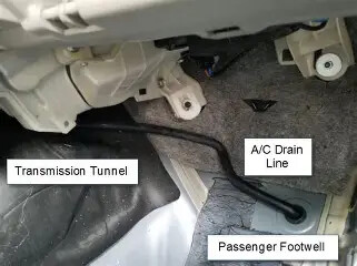

Cleaning out the AC drain tube? For $170, no.

Many times, I have been surprised by customers who will continue driving on tires that are in poor condition. When a forum visitor asks about minor dry rot cracks, they have been told to drive slowly to a tire store because their tires could blow out at any time. That might be an overcautious reaction.
The tires in the picture above have been dry rotting for 2 years. When should he take action?

I personally wouldn’t drive on those tires.
$170 to unplug ac drain tube? That’s 3min with screwdriver.

Is it easy to reach on a Rav4?

Thanks for the pic, saving it for future reference. OK, new tires in the works.

Those tires are TRASH! REPLACE THEM NOW!

I’m a cheap old guy. My advice is only go to the dealer for exclusive, proprietary stuff. Any competent mechanic could take care of everything on that list for less. I would agree the tires need to be replaced. I would not drive the one pictured at highway speed for any distance. Brakes would need to be seen. Not sure what the replacement interval is for transfer case and diff on this specific vehicle but many are 30K miles. Sometimes the dealer is the only answer; this is not one of those times. I can’t be too ■■■■■■■ the dealership. They are just passing along their cost of doing business that includes training their mechanics, keeping a parts inventory and paying whatever kickback they do the the brand. Just because they ask doesn’t mean you have to pay for all that.
